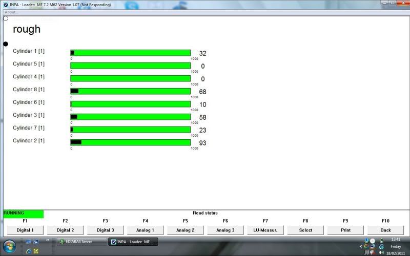

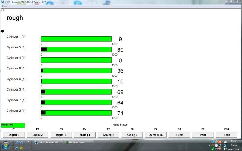

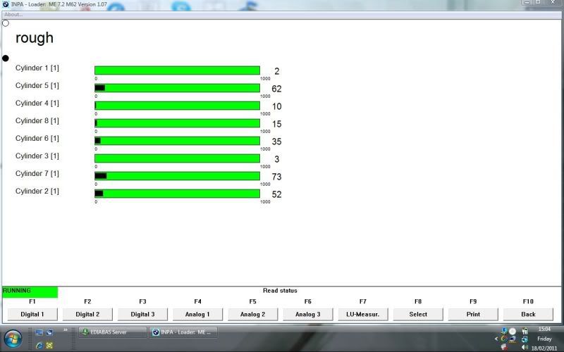

I did as 'Memyselfundich' suggested and got myself INPA. Here are some live data pictures of the cylinders:
I'm not sure what all that means so, maybe some of you German experts could confirm that they don't look too bad. Or do they seem not to be very well synchronized?
