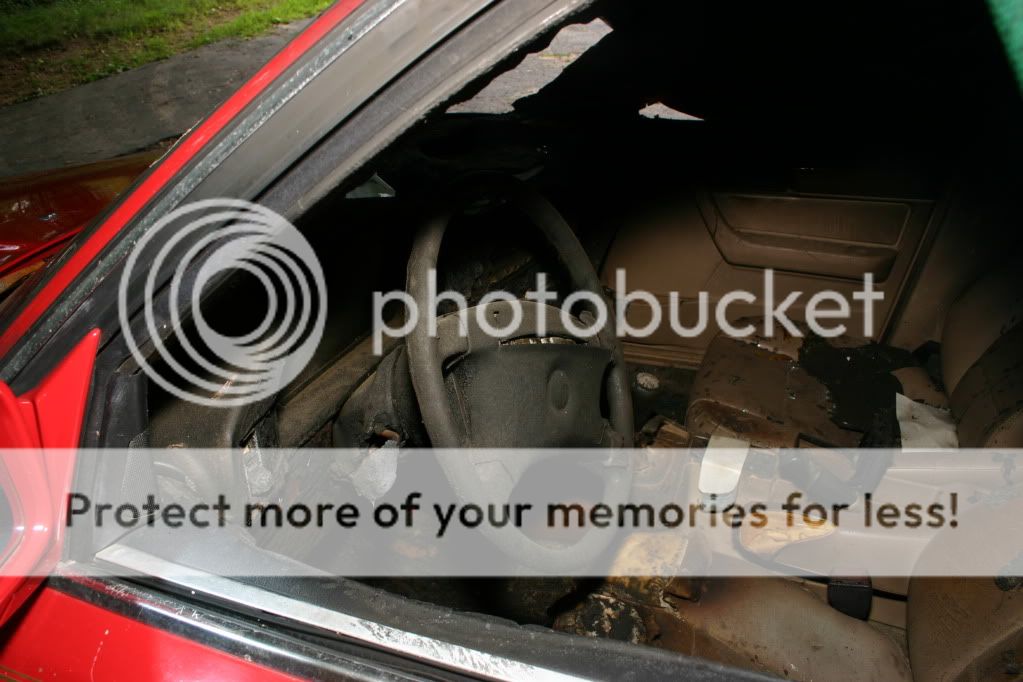

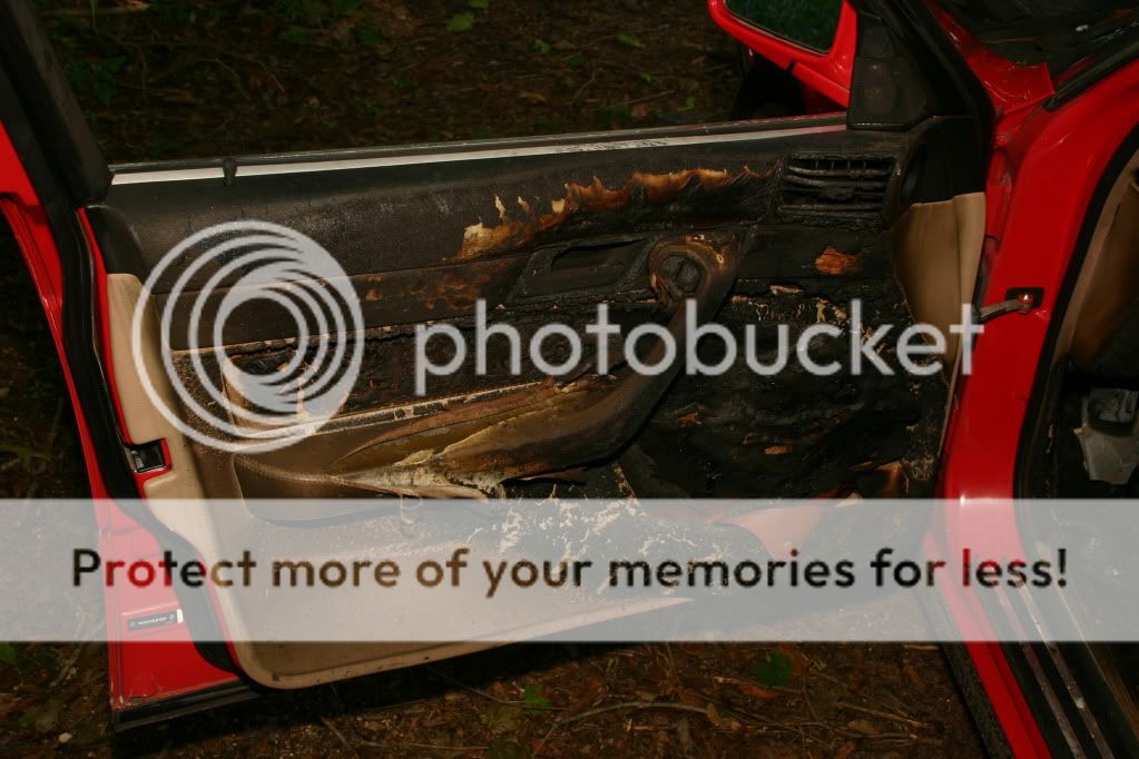

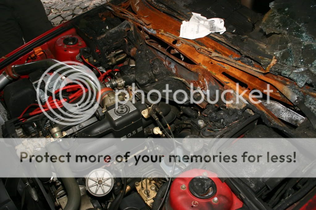

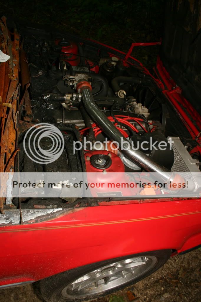

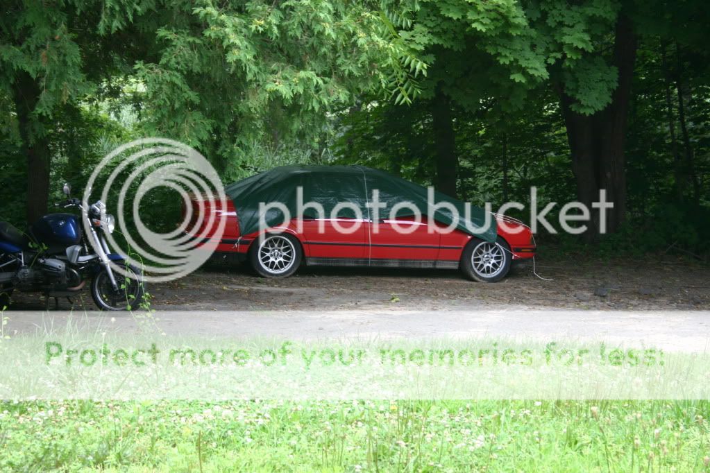

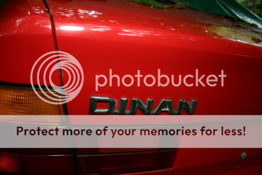

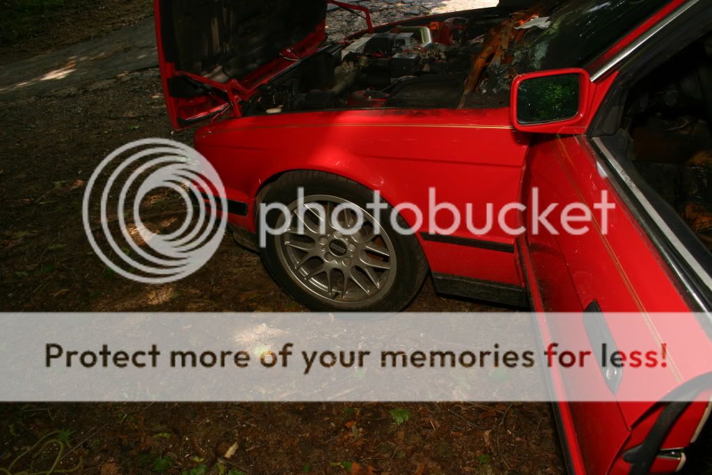

So we have a long-time customer at the shop, whom I'll call Mr. X, because I really don't need to mention names. Mr. X Called me out of the blue on my cell today, he wanted to see how I was, and talk to me about a friend of his who had a Bmw. He said he thought it was a 5, but may have been a 3. Thought it was a 2 door, but it was under a tarp so he didn't really know, he'd only seen it at night from a distance. Supposedly it had had a dash fire but it wasn't too bad, and the owner was looking at options for the car. I told him to forward my contact info and I was interested in talking to the guy.
A little while later my phone rang, and it was Mr. Y, he now had my number and was looking to see what could be done with the car. In the middle of the conversation I interrupted him and asked if he was home, and could I come look at the car? He said of course, come on out. I did. The pics will tell most of the story, but let this serve as a warning for all of us!

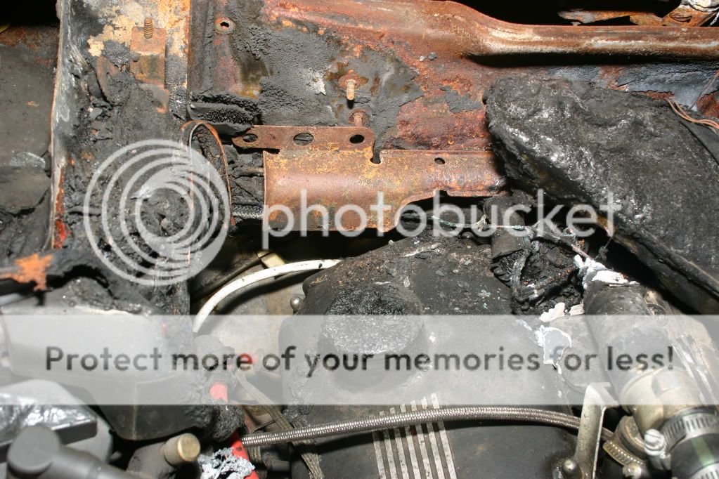

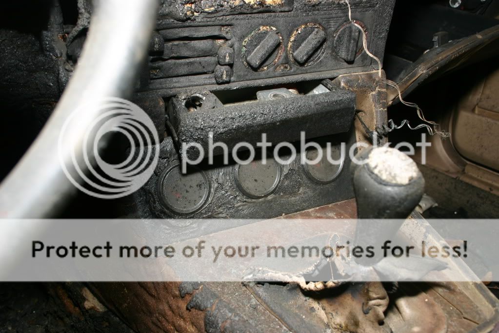

The blower motor caught fire and the car was a loss. Totaled. Done. Interior is 100% gone, body panels are pretty good. The hood has two dents that may or may not bang out. The suspension is all recently done. It has the Dinan turbo kit. It's got the BBS RC (I think, I don't know BBS wheels, feel free to correct me) with new tires. Huge brake calipers. The owner had been asking a lot for it previously, and it was to deter people from actually buying it. You know the deal, ask high so when you get your price you feel good sitting on that pile of cash.
We talked for a good couple hours and really hit it off, and the current plan is to find out what the market for Dinan turbo cars is. If it's cost effective, we'll pick up a super clean 95 e34 somewhere and all the Dinan goodies will go into that. It's got the built m30, owner says it put down 425hp at the wheels. If the cost of swapping it all over isn't worthwhile it will likely be offered as a whole parts car, or parted out as a few large items (engine/turbo, 5spd swap kit, suspension, wheels, brakes, etc...)
We talked about bringing it back with a FULL interior swap, new harness etc..., but since the A pillars have been partly cooked, including the firewall, coupled with the salvage title it's just not going to be safe or worth it.

how did the blower motor catch fire? was someone in the vehicle?
is there anything people can do to prevent a similar catastrophe?
Probably seized up due to a bad bearing, the blower motor had to have been squealing.
So far as the blower motors go, the motors may exhibit symptoms of stoppage, but more than that they just go bad internally and pull more amps. It's not enough to pop the fuse, but because of the high amp draw the wiring gets REALLY hot, and well... you see the results. It's not an uncommon thing in e34s, I've seen several in junkyards burned, all from the blower motor.
